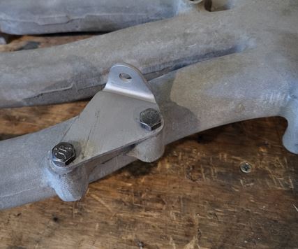

I have a very good friend in Germany who made this for me.
It is a copy of his bracket that was on his manifold.
This is correct for 60-64 cars that use the twist rod pedal.
Like all Hyper Pak parts it is seldom found in the wild.
Usually missing and only useful if you have one of the first generation A Bodies.

Looks good. My hyper pack does not currently use a twisty rod throttle.
I also thought the twisty rods on the 1bbl cars were in use until 1966? maybe 1965 and 66 used the throttle cable, as I am not very familiar with those years in OE slant trim.
I guess you need to make a lot more linkage if you want to run the carb in the other direction with the throttle rod. Did the Hyperpack come with a longer rod to replace the one barrel rod, or make your own?
Get some measurements and I can Make a CAD Drawing of it. looks like 3 ~ 5/16" Holes and one bend on a triangle.
I can give the drawing to you or share it if you want to give away the IP.

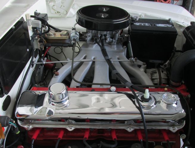

Yes uses a much longer rod, have not found that.
I made the one on Lancersaurus.
I don't see the need to change the direction.
The throttle bores are sized for the 3083S Carb, smaller toward the engine.
