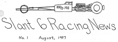

Where it all began:
Here is the very first SSRN article published in August 1997.
This was the cover drawing of that first SSRN:

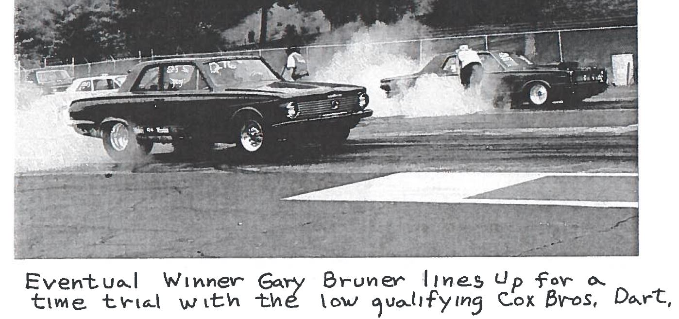

Here is the very first race report from that first SSRN #1 in August 1997:
GARY BRUNER SHOOTS OUT SIXES AT BRISTOL
Here is the photo to accompany that first race report.
I have the color originals back in KY. Hopefully someday I will get around to scanning those as well...
Both Desperado and the Cox Brothers 66 Dart were red. :wink:

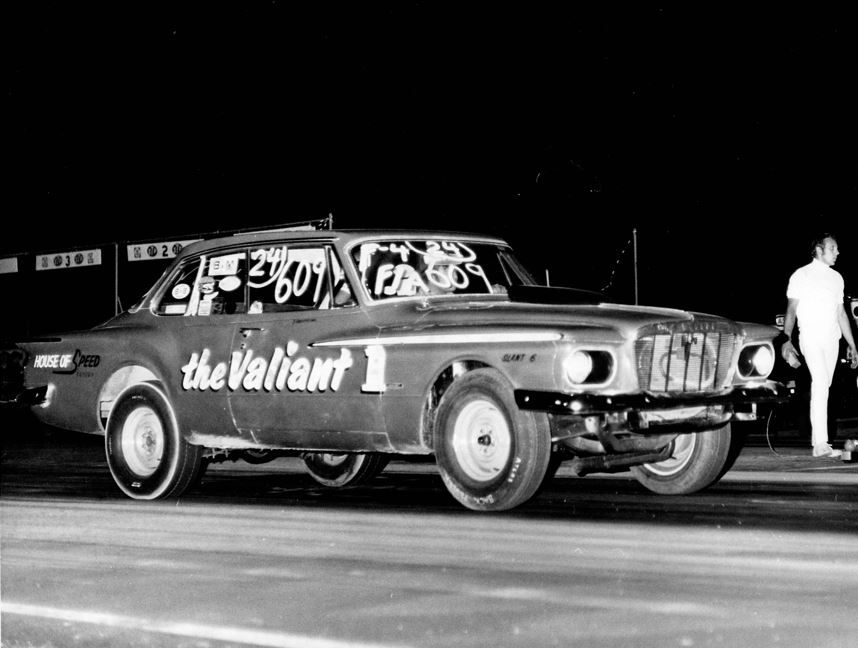

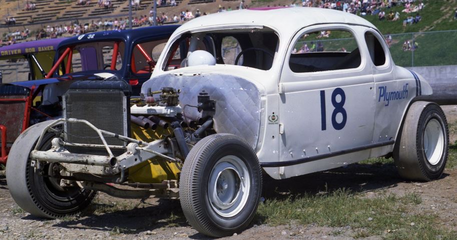

Check out this header science!
