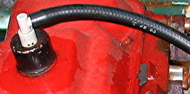

If you don't want to mess with hunting up obsolete parts and you'd prefer to shop for a current-production PCV valve, the one you want is Chrysler/Mopar № 05175351AA (or just 5175351AA if you prefer to omit the leading 0), such as this one (or you can pay triple the price if you want). These currently-available PCV valves are a different style, made partly or completely out of plastic, and require some adaptation to use with the pre-'66 valve cover and PCV cap. You make a sandwich in this order: PCV valve (push the non-hose end through the cap from outside to inside), spring retainer, grommet (push onto non-hose end of PCV valve from the bottom). Sometimes the spring retainer won't fit over the plastic valve and you have to leave it off. Push this "sandwich" onto the valve cover chimney. It won't look quite original, but it'll fit and work fine:
