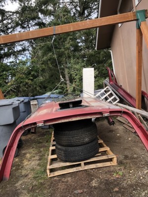

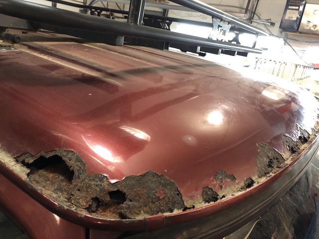

I know we all love pictures, so here is the rust I am looking at and the replace ment roof section I have. The two rusty areas pictured are the worst, but every window and door opening has at last rust bubbles in the drip rail above it, if not outright holes. And I won't even post pictures of the floor and quarters.
Realistically, I will probably end up cutting the roof off at the middle of the A pillars and the bottom of the B and C pillars. I think I will plan on using body panel adhesive to insert reinforcing rods into the A pillars before I weld them up, and I might glue some backing reinforcement plates behind the welds on the B and C pillars. I think the labor saved by replacing the roof in one piece makes that the best option.
Once I get the roof fixed I can actually drive this as I patch the floor and all the other rust holes on the truck.
Hoping to get some input from people more knowledgeable about bodywork and automotive structural engineering.
