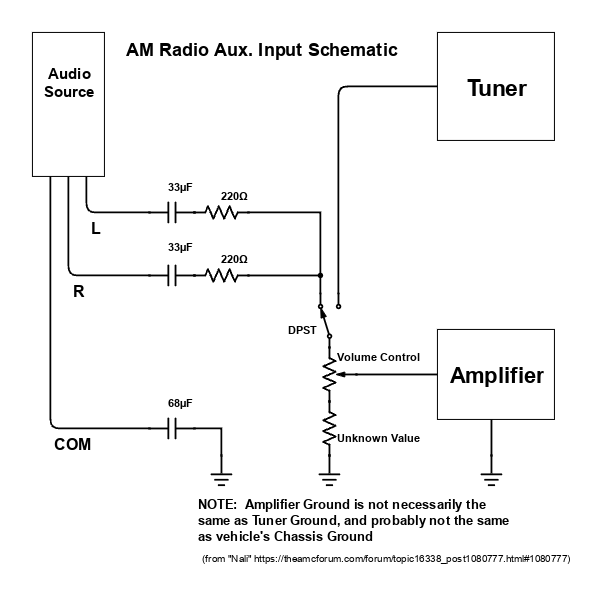

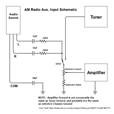

I came across a plan from a gentleman named Nali, posted on the AMC forum in 2011, which seems to make sense, but I wanted some clarification, and there's no response to my question over there (surprise).
I redrew his schematic, and have posted it here:
Basically, you break the line-level output from the tuner stage to the volume control and instal a DPST switch (or a switched 1/8" jack), the two 220Ω resistors allow you to combine the Left and Right channels without harming the Bluetooth unit's line-level amp, and two 33µF and one 68µF caps filter DC.
The "ground" level of the AM Radio's audio amp is definitely not the same as the chassis / vehicle ground (I have the Sam's sheet for the radio), so that needs to be isolated, as the standard available Bluetooth units carry their grounds from the USB power plug through to the common of the 1/8" stereo connector.
I am not sure whether he intended the "Unknown Value" resistor to be one that I would use, or to be representative of the resistance already in the system after the volume pot.
My actual plan is to make a very small sheet metal panel, maybe 3/4" tall, to screw to the bottom of the dashboard using the fuse block and radio bracket screws, containing two USB-A receptacles and two USB-C receptacles, plus a 1/8" stereo Aux jack and a DPDT "micro-mini" toggle switch I have, to provide for charging, Aux input, and switching between the Aux input and the AM radio. I have a very nice little Bluetooth receiver that plugs into a USB-A for power and has a 1/8" plug on the other end for output that I could then plug into the panel.
My questions are:
• Do the values of the resistors and the caps look okay?
• Does this look like it will adequately isolate the radio's components from the vehicle ground?
• Does anything else look wrong / Does this look like it will work, without releasing the difficult-to-replace OEM factory smoke?
• Any other suggestions (other than the 340 or the subwoofer)?
Thank you in advance,
– Eric
