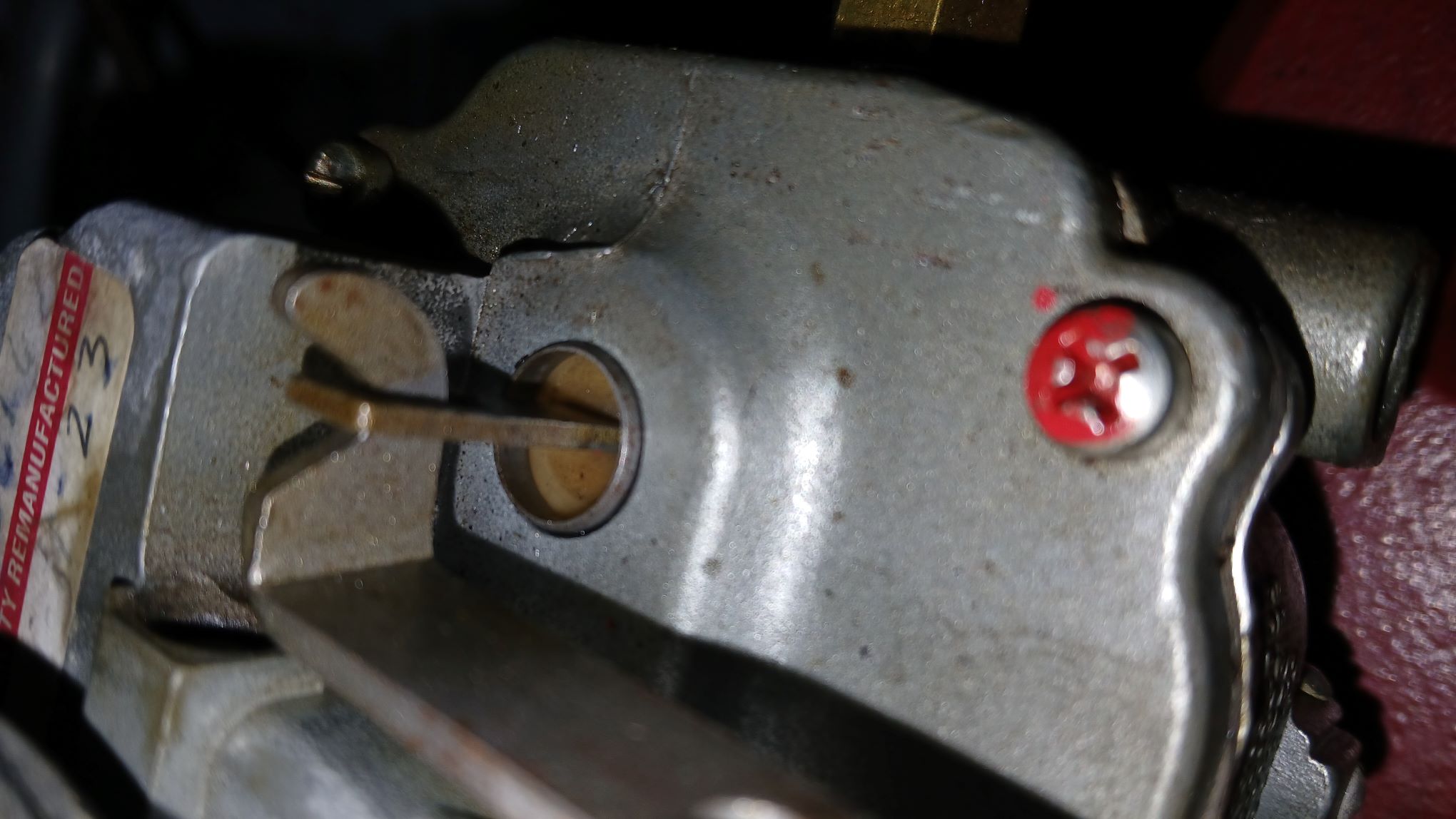

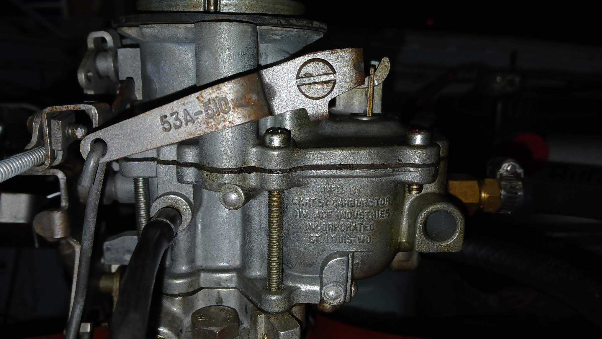

So here's the situation. I have this remanufactured BBS on my '66 225 Dart. I've put hundreds of miles on it and it seems to run pretty well other than two slight issues:
1. The exhaust always smells very rich despite any adjustments I make to the carb.
2. On hot starts, the throttle must be held wide open to start, even after short drives.
This seems to be a later BBS (I'm guessing from a '69+ truck since it has a choke cable bracket and no vacuum pulloff) I'm beginning to wonder if the bowl vent could be part of the problems. Or if it is missing parts or has just been assembled incorrectly. I've done some searching and can't seem to find another BBS with this setup. (See attachments below) They either have a "cap" that opens and closes with the accelerator pump, or a plastic vent tube on top of the bowl. So my main questions are, is this bowl vent setup correct for this era of BBS? And could an issue with this vent be attributing to my symptoms listed above? any insight would be appreciated!

I am by no means a BBS expert, but I can make some general comments.
1. Have you owned cars from this era before? If so, have you owned them recently?
I ask this because the normal exhaust of a car from 50-60 years ago will smell rich compared to a modern car, and if you're not used to it, it might seem abnormal.
2. It's not unusual to have to start a hot engine with the pedal on the floor, and many of us had cars that were fine, but needed this throughout their entire lives.
3. Why did you install a reman. carb?
More importantly, did you keep the old one (especially if it could have credibly been the original)?
Remans tend to be crap, and you have no idea what sorts of parts are floating around inside there, or how they've been adjusted.
4. Bowl vent looks fine to me. What do you think is wrong with it, and why do you think it's a concern?

First off: the problem you've noticed is real, not imaginary. You should not have to floor the accelerator to start the engine, except very occasionally under specific circumstances.

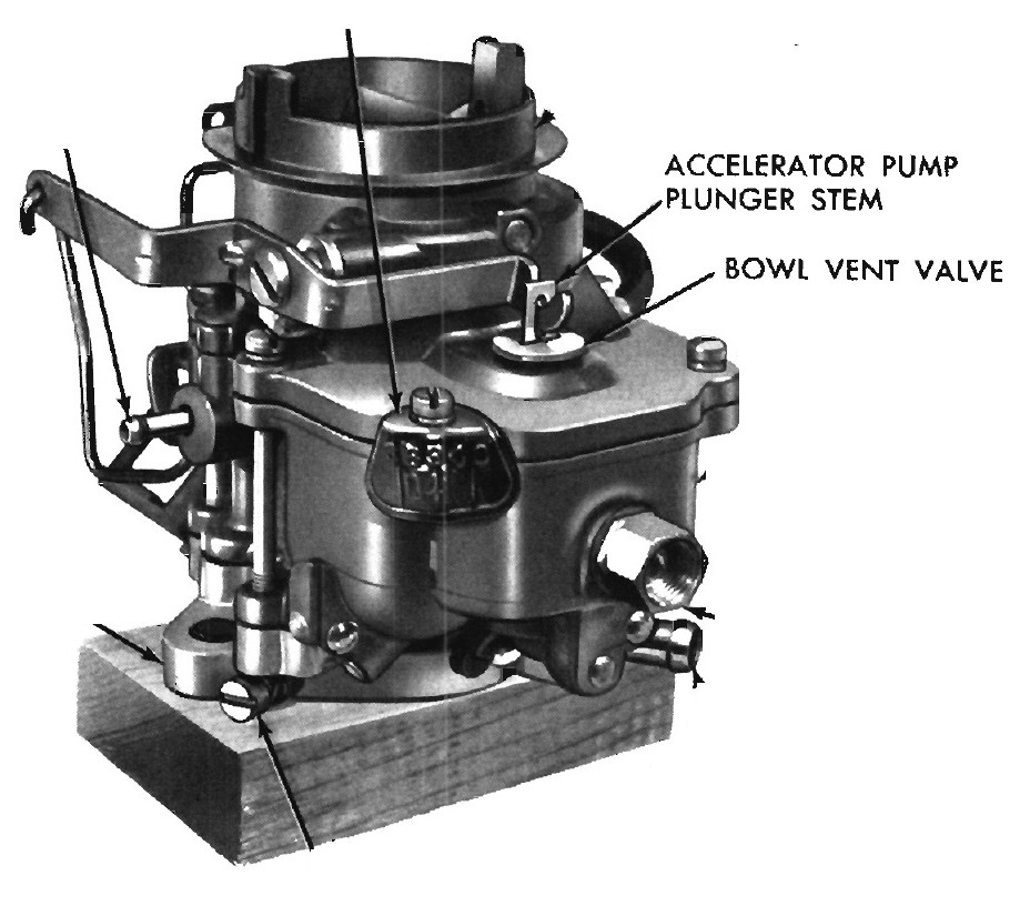

The cause of the problem—at least one of the causes—is there is no external bowl vent on your carb. There's meant to be a round metal disk atop the carburetor casting, with a slot through which the accelerator pump stem passes. There are three grooves on the stem. A hairpin clip is installed on one of the grooves—which one corresponds to which hole in the throttle lever contains the link to the accelerator pump lift lever—such that when the throttle closes and lifts up the stem, the disk is lifted up by the hairpin clip to provide the bowl's external vent.
Instead, the "remanufacturer" installed wrong parts—a plastic disk under the carburetor casting—such that there is never the intended atmospheric bowl vent at closed and near-closed throttle. This setup is appropriate only for '70-up California and '71-up 49-state/Canada BBS carburetors with a separate external bowl vent valve and a ducted bowl vent outlet, which your carb doesn't have.
The missing disk is identified here as "Bowl vent valve":

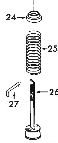

There's a little metal bushing/hat, the bowl vent valve seat/accelerator pump spring retainer, which goes at the top of the accelerator pump spring and protrudes upward through the carb casting, to give the disk (bowl vent valve) a uniform surface to seal on (it would not do so against the uneven top of the carb casting). The bushing, identified here as 24, is Walker part № 22-53; no idea if it's still available, but from your photos it looks like that part is present on your carb, so all you'd need is the disk.

There's no aftermarket coverage of the bowl vent valve disk, but it (with that seat/retainer bushing) was used on gazillions of BBS and BBD carburetors pre-'71, so you ought to be able to scare one up.
Fix this (all the way fixed; this will call for careful adjustment of the accelerator pump stroke and bowl vent opening per the service manual), double-check your float adjustment while the carb is apart (see here), and the problems should get a whole lot better. Yes, this means you'll be opening up your carburetor and will need a rebuild kit for it which contains good gaskets. Parts store kits are no damn good any more, when you can even get them. Go directly to The Carburetor Shop for a worthy kit. It'll cost more than parts store trinkets, and it'll be worth it. Since there's no longer a carb ID tag, you will have to specify a closest-guess carb (№ 4905s) to get a correct kit. Set the float to 7/32", using the correct gauge, per the procedure in the manual.
