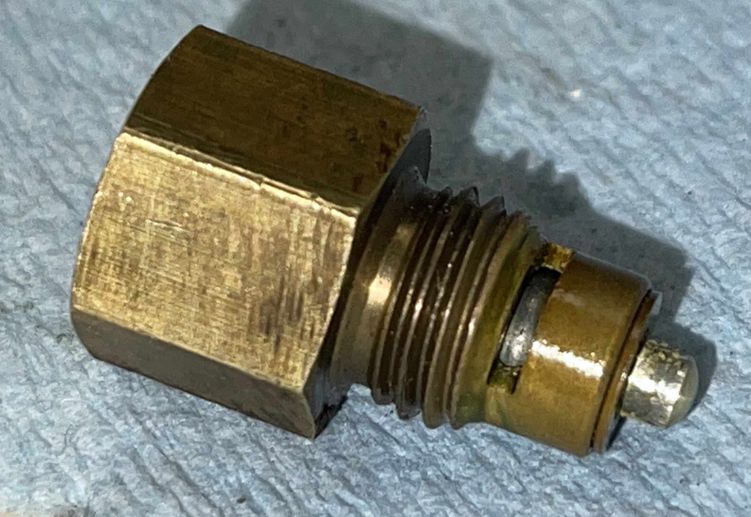

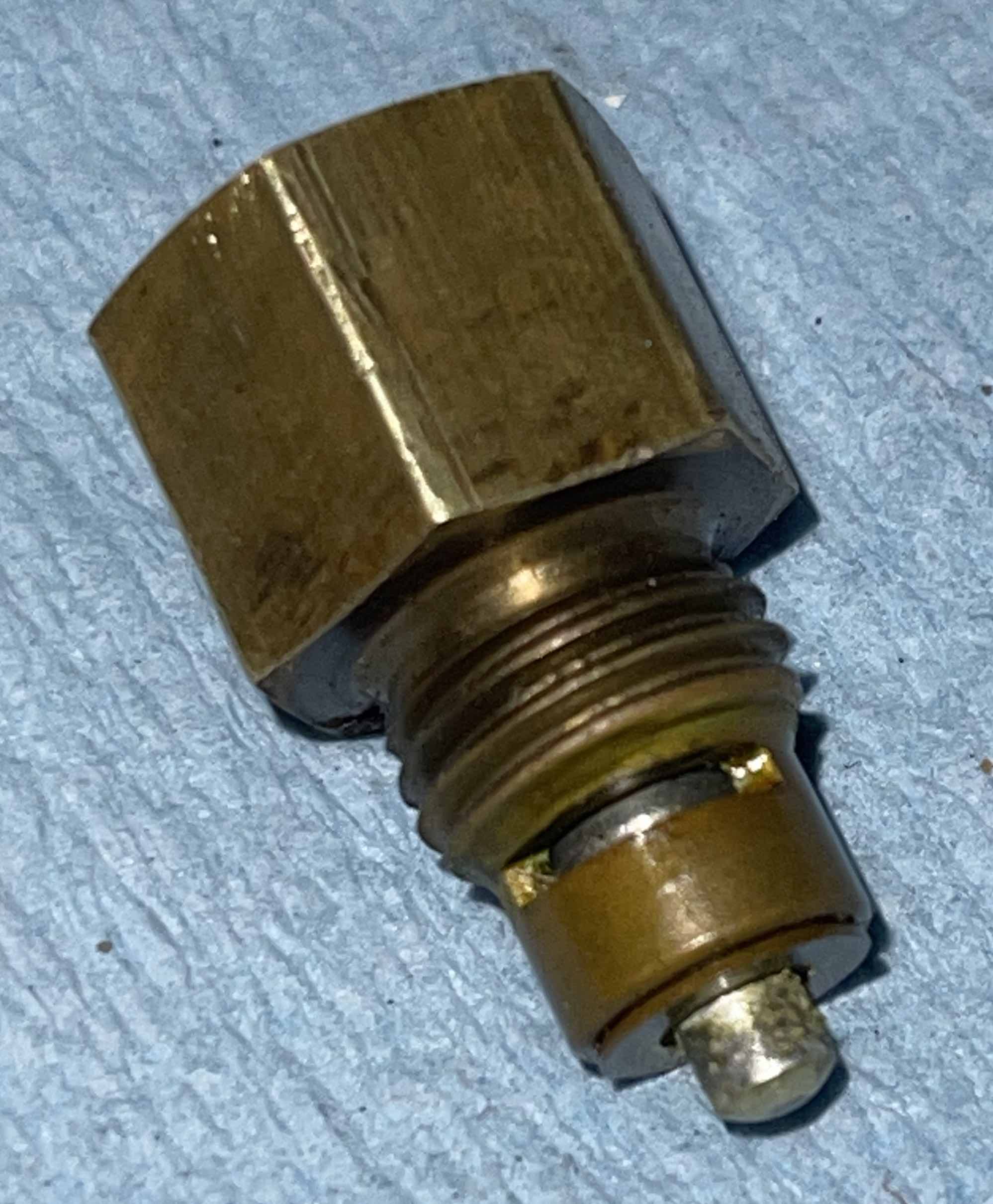

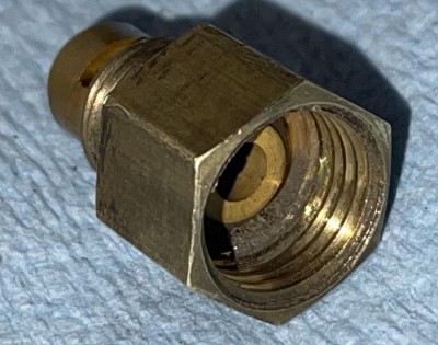

More I think on it, more I suspect your float valve is making a pest of itself. That "Daytona Float Valve" they claim is so much better than a regular ol' normal ol' boring ol' inlet needle and seat, that's a copycat of the old Tomco "Duro-7" design, and — assuming it was a good design in the first place — something might've got lost in translation. I can think of a few ways a not-quite-faithful copy would cause problems such as you're having.
Too, and secondarily, I've never liked those red fibre inlet fitting gaskets. The rubber-coated aluminum ones seem to do a better job of keeping things dry. Might wanna sigh, grumble, and fetch a kit from Jon Hardgrove at TheCarburetorShop.com . It'll have the regular kind of inlet needle/seat, and together with careful float readjustment will likely solve all or most of the problem(s).
I've probably rebuilt this carburetor at least three times in the last 15 years. Only this last rebuild did I finally try that "new" Daytona float valve you say is a copycat design. I've tried using it in the past and had problems with it. The first two rebuild kits from Daytona came with two different options for the fuel inlet: 1) their 'new', copycat design, and 2) some kind of a brass fitting that has some sort of pressed-together plunger-seal valve. I ended up using that one because it worked. I saved that fitting: perhaps I'll re-use it for now. Pictures of it attached, below.

That's a Holley-type design which works well on certain Holley carburetors. It does not belong in your Carter carburetor, where its side-discharge configuration will tend to make gasoline want to exit the carb through the bowl vent…in exchange for zero benefit.
Writing this now, I'm thinking back on other nonstandard float valve designs. The Grose-Jet, for example, used two metal balls and no rubber. Similar claims as for the Daytona Float Valve: ZOMGWOW!!1!!!!!1!!! GREAT MASSIVE BIG IMPROVEMENT IN CARBURETOR FUNCTION!!1!!!1!!! REVOLUTIONARY NEW DESIGN THIS CHANGES EVERYTHINGS!!!!1!!!!
I found the Grose-Jet didn't practically improve anything about carburetor operation, and it made new problems very much like those solved by the 1961 introduction of the rubber-tipped inlet needle.
So anymore, I'm inclined to file magic carburetor float valves right along with magic spark plugs, under N for Nope.
:!: Ahh....no wonder the bowl vent area has appeared wet for years. Never put that together. Well...shoot. Need to change that out to the tried and true needle/seat.

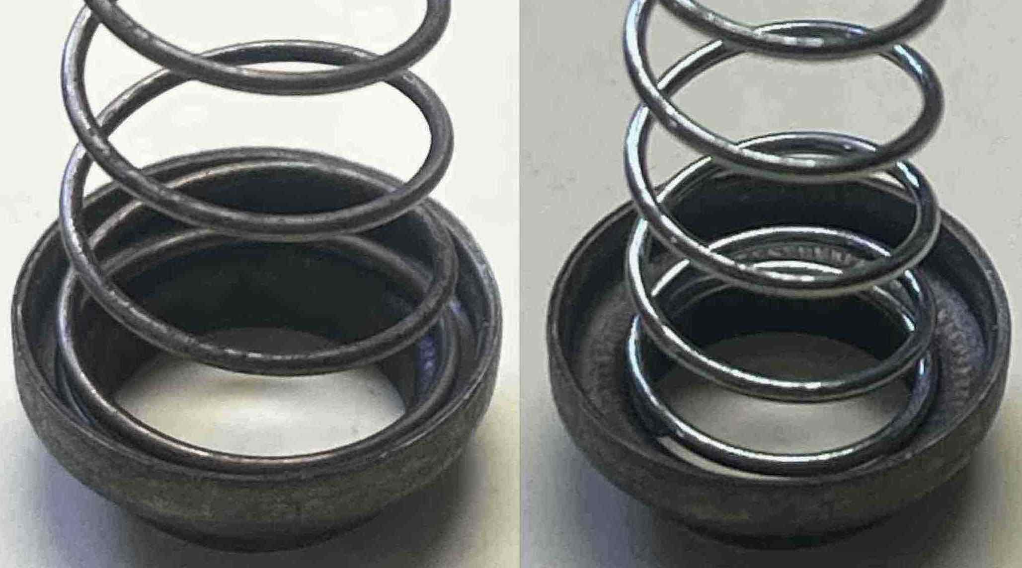

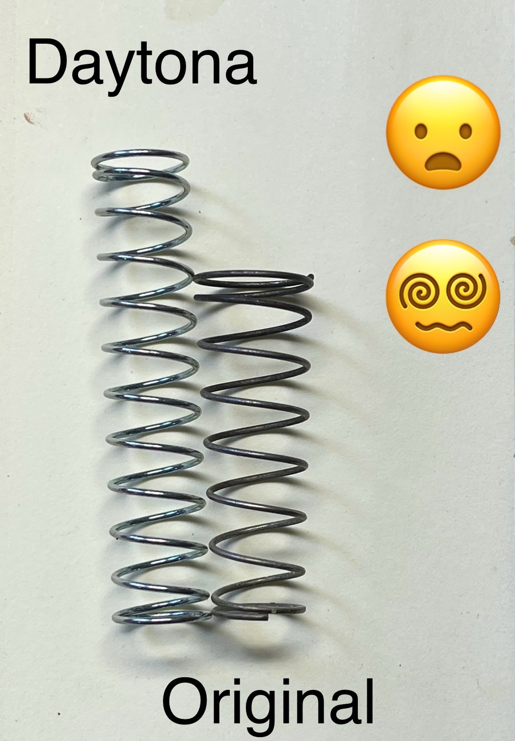

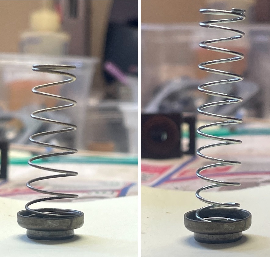

I have reused my old pump spring many times because it seems tapered correctly from narrow at the plunger end, to wider at the top end to mate with the metal 'cup' that seals the pump vent hole.
Confirmed; that's the correct design. Carefully stretching this spring pays dividends. Grab it with pliers at both ends and stretch it just past the point where it springs back to exactly where it was before. Not too far, or you'll spoil the spring. You want it to wind up just a little longer than it was.
The new accelerator pump springs that come in the Daytona kits do not taper at all. Their coil is wound too tightly so the end of the spring that rests inside the rim of that metal cup doesn't sit around the edges of the cup correctly to press it firmly up against the inside of the airhorn; all the spring wants to do is poke through the center hole of that cup seal.
More I hear about Daytona's kits lately, dimmer my view of them. This plus the other bum parts already mentioned move them into the do-not-buy category as far as I'm concerned.

Original spring length measures 1 5/8". Daytona spring measures 2 1/8". Now, I'm questioning their parts, wondering what length is correct. But Dan, you said stretch the original spring so it returns to just past its original length, that would still be a good deal shorter than the Daytona spring...?
PS: MAN, that original spring does NOT want to stretch longer! It keeps returning to the same length and I’ve gone past where I think I’d need to go to get it to stretch. Stern stuff this old spring.

Thanks to everyone who's weighed in on this. Finally got the original spring stretched a bit and reassembled.
Wow. :shock: What a nice difference that makes! No stumble at all. Strong jet of fuel on acceleration. Drives like it should now :D
