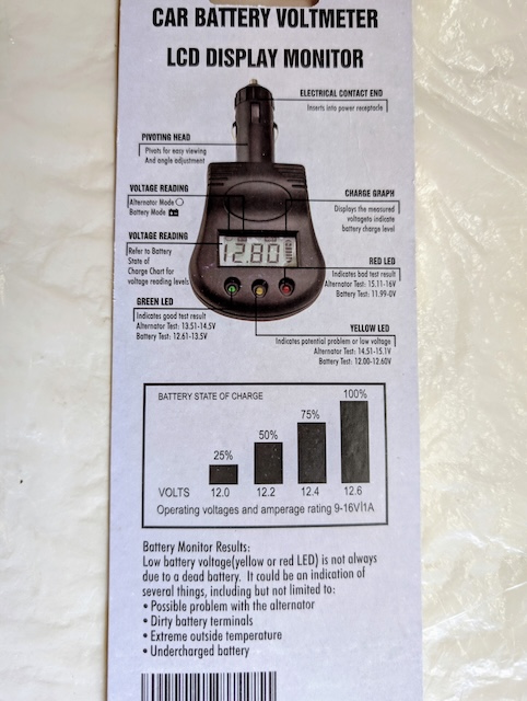

So after the fact I bought a cheap accessory plug volt meter and checked my others cars as well. It doesn’t work in the cigar lighter, but I have installed accessory plugs for external device management..

Here is the voltmeter gadget I got to easily see battery stuff without the multimeter hassle if you only have an ammeter and you have added an accessory plug. Cheap Chinesium from Amazon but seems helpful to me.
