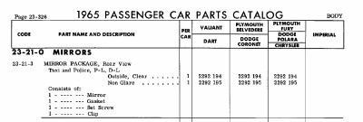

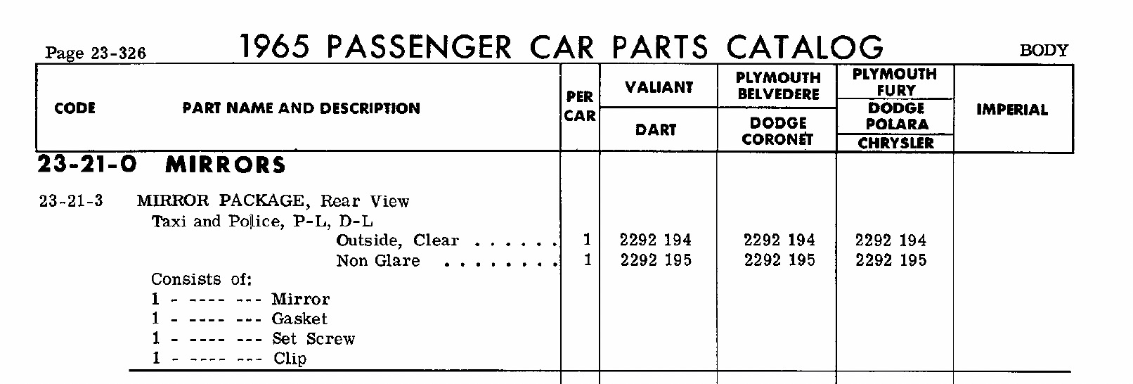

All that said: you might want to see about finding a 2292 194, which was the upgraded — larger, more adjustable — non-remote sideview mirror marketed to police-taxi car buyers:
That's this one (the linked one would need its glass replaced or resilvered). I have a faint bell ringing at the back of my head, saying I might have one of these mirrors on shelf; send me a PM if you want me to check.
