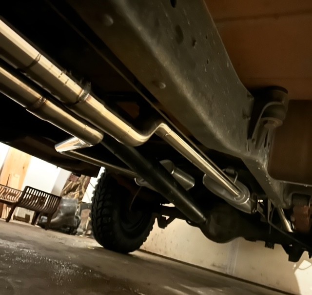

File comment: I'll look into it. Would my exhaust configuration/reduction of backpressure have anything to do with it?

Lou - I never rejetted the carburetor or messed with the accelerator pump setting...i'm thinking it may just be running lean since it's bogging down. My Holley 2300 350 CFM is straight out of the box. Thoughts?
PostPosted: Thu Feb 13, 2025 12:27 pm
Posts: 17208
The 350 should not be that far off out of the box. Make sure the valves are lashed properly and you map your timing curve, especially since it's an aftermarket distributor. Or for a coarse test, just try advancing it 10 deg and see if it runs better. If worse, retard it 10 deg from where you started. My wild guess is the timing needs to be advanced, but hard to say. You made a ton of changes in one go.
