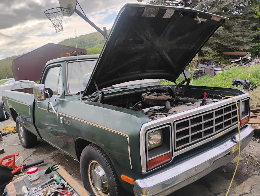

Life has been busy for the last 9 years . The truck owes me zero it has made money for me
in the past . It has waited to be brought back . It was always a bit rough , some rust dents
It lost some Zest . but really about the same . This is the project . I work alot I most likely will send to a shop

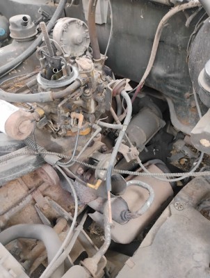

Labor to convert to non lean burn 3 hrs at $150 Parts I buy But
If by chance issue is fuel tank pickup line and runs fine like days past . Then good enough .
just a nice knock around country truck , original paint naturally .

$450 just in labor to swap over from lean burn? I guess I am out of touch on current pricing

Mr.6- $450 in labor to convert a lean burn vehicle to standard carburetor and ignition is robbery. By far the most expensive part of that conversion is parts. You need a late 70s non-lean burn system Holley 1945 carburetor, a slant six electronic ignition distributor, a GM HEI module, a standard relay, some wire, and some crimp on connectors. The stock wiring harness does not nee to be modified in any way. Remove the factory negative lead from the coil. Wire the HEI + and - to the coil + and - (or, if you are using a relay, wire that into the HEI + feed). Run the two reluctor leads to the distributor. Install the non lean burn carn and distributor. Done. Very simple. A mechanic that knows what they are doing can accomplish all of this in well under an hour.

Hell yeah $450 is more than highway robbery... Even if you find someplace to "have"it done
(If that's even possible these days because there's still gonna be no port for plugging in a scanner haha)
