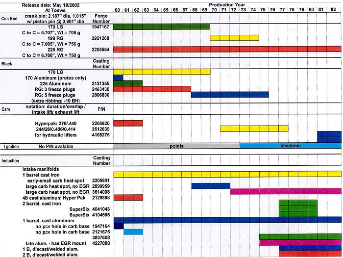

Thanks for the clarification on the 170 year models. I pulled the data originally from a chart from here in the forum. In my haste to make this post I read the chart wrong. :p
I’ll be sure to correct my original post. I did know I will need the 198 forged crank for this but I was hoping to find the 170 with the matching crank because I actually have 3 variants of this 170 built I want to try but the stroker with the super charger is where I want to start.
I have searched online for 170s but they seem quite allusive. But I do know I want the ‘68-‘69 castings because they are reported to be the better ones to use.

I personally doubt the 68-69 170 engines are any better than the early ones. As far as I know there are no differences in the 68-69 170 engine from the 67 down except for the crank shaft
(larger converter pocket).. Unlike the 225 engine that went from 3 freeze plugs to 5 freeze plugs (possibly othe mads as well) the 170 kept 3 freeze plugs untill the end.

170s were made 1960-1969 (or 1968?) and 198s were made 1969-1974, IIRC.
170s were made from '60 to '70something, though only for export outside of the US/Canada market after the '69 model year. I mention this because a bunch of years ago there was someone selling off a stash of NOS (in crates) '70-'71-'72 170 short blocks.
198s were '70-'74. US/Canada only, as far as I know.
