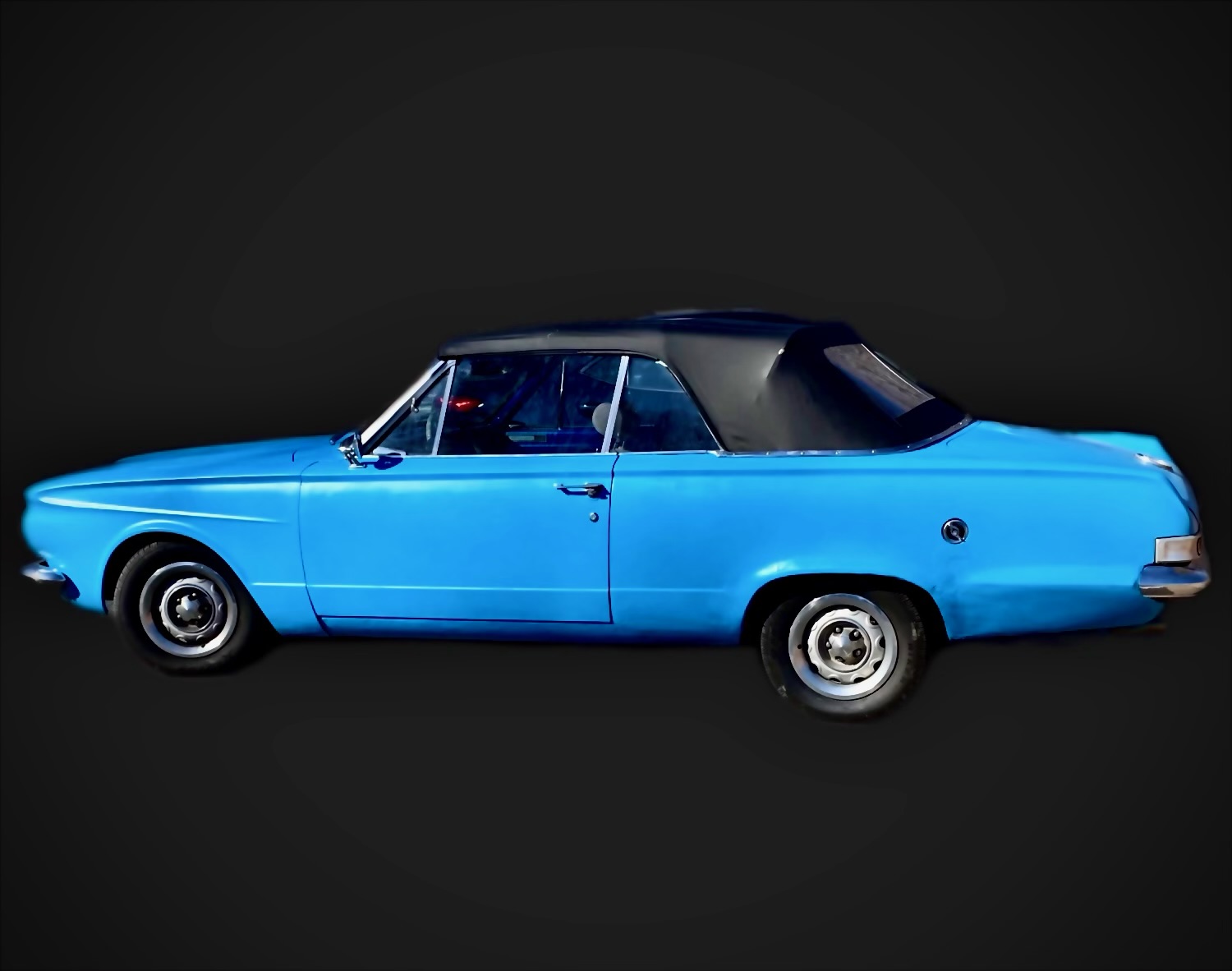

Thank you for the guide to wisdom of understanding of budget building an A Unibody car.
This forum is a remarkable find. Thank You Dan for guiding me (steering) me in to a good
place to start (stop).
Steering and stopping will be my first focus.
I have standard stock steering assembly and stock drum and disc brakes on the car currently.

PostPosted: Sun Jul 17, 2022 12:56 pm
Posts: 430
Location: Lawrenceville, GA
Car Model: 1966 Dodge Dart
Stock discs are pretty decent unless you plan to go endurance racing; only drawback is that some replacement parts can be harder to find than later single piston calipers. Well, that and the smaller selection of wheel options for the 5x4 bolt pattern. The 11.75" discs you sometimes see are overkill for street use... But they aren't any more work than smaller disc if you're swapping from drums, so that's why I have oversized brakes.
As with the engine, brake and suspension plans should start with a goal and budget.

PostPosted: Mon Jul 18, 2022 12:52 pm
Posts: 17208
If using SBP Kelsey-Hayes discs, I suggest using EBC Yellowstuff pads on the street. The parts store pads on my 68 Dart (when I ran KH's) were awful and EBCs should make a big difference.
Also, 11.75s are just much better than any 11" disc setup. You need as much brake as you can get so you don't rearend people on the street with way better brakes than you! Basically, that's everyone these days.
