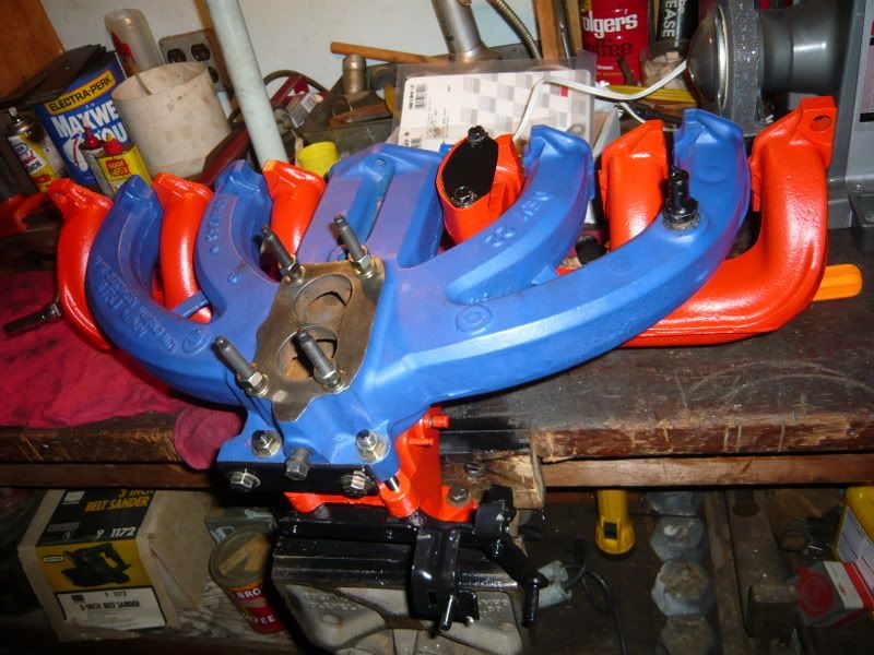

here is the exhaust manafold, 2 cans of blue paint where defective and the parts store was out of blue and black so ........... its orange!
you can see the cutout choke pocket here: (i wish i knew not to do that cause it was a &%#$!)
i am still working on the carbrator, i just might take it to a carb shop and have them do it. next weekend i should make it up to wildcat and grab my missing kickdown parts & the fuel line (fuel pump to carb) off a super six bbd sl6. i just need one of those nice australian gaskets for the manafolds. oh and have the manafolds leveled @ a machine shop.

here is both manafolds assembled, i am going to put as much of it together as i can so i can see what i missing. i'll prolly find a machien shop in pdx to level them, then i'll install gaskets and get ready to put it on.

Nice work on the manifolds, Don't torque 'em together till they're on the head. :wink:

Nice paintwork...be ready, though, because only the very highest of high-temp paint (VHT) keeps its colour at the temperatures the exhaust manifold will see. Regular engine paint will fry and emit a great deal of stinky smoke until it's all gone.

I have had pretty good luck with woodstove paint. It only comes in silver and black afaik.

well the paint is 1200 F so i hope it holds for a while. funny that you mentioned woodstove paint 70valiant cause i was actually thinking of using it but i could only find black.

I used the silver on my clifford shorties. Once painted you start it untill they smoke then shut it off, let them cool, and do it again 2-3 more times and the paint will not peel off.

makes sence i had to cook the paint on both manafolds using my gas heater ... its in one of the picts,for about 200 deg for 24hrs on all sides. then i used a electric test probe from my fish tank to get that temp. kinda getto but it was all i could do. gonna let it idle for a bit once they are on and i hope they dont cook to much :wink:

the paint i got was exhasut manifold paint rated at like 1900 i think, its only faded slightly, and it was silver. but i cant imagine what that orange will do, post up on some 1000 mile after pics. and the black nipple on the intake? you goin powerbrakes?
