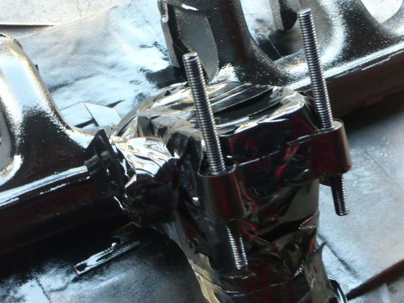

here is a few parts cleaned up and painted with 500deg engine paint. ( i am using 1200 deg paint for the manafolds btw: its mopar blue, the other parts are gloss black)
scrubbing and cleaning. I also unlocked the flapper so its moving freely

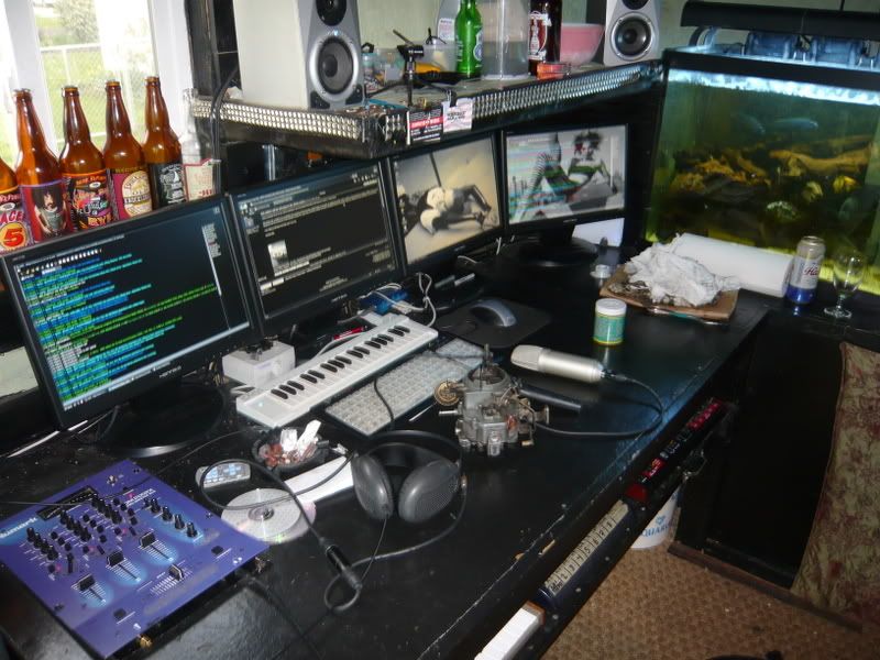

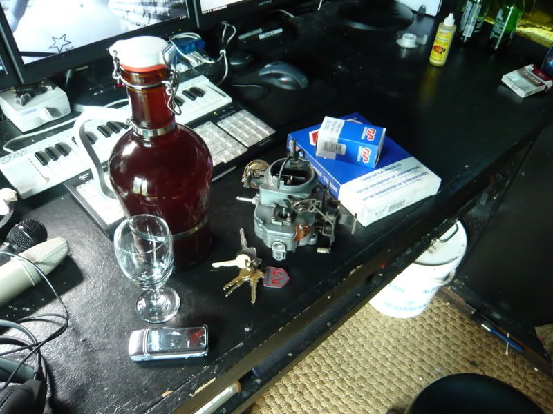

rebuilding and cleaning a carter bbd in my studio/server room when i get off work @ night

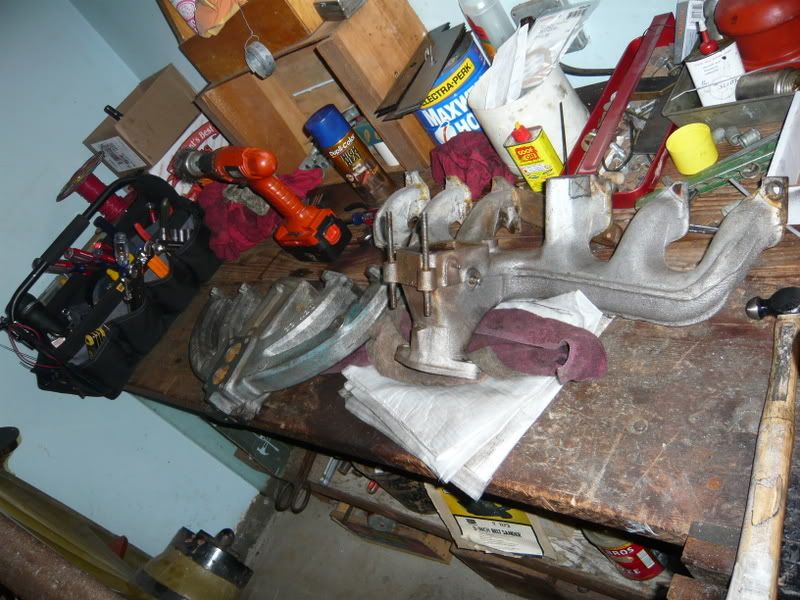

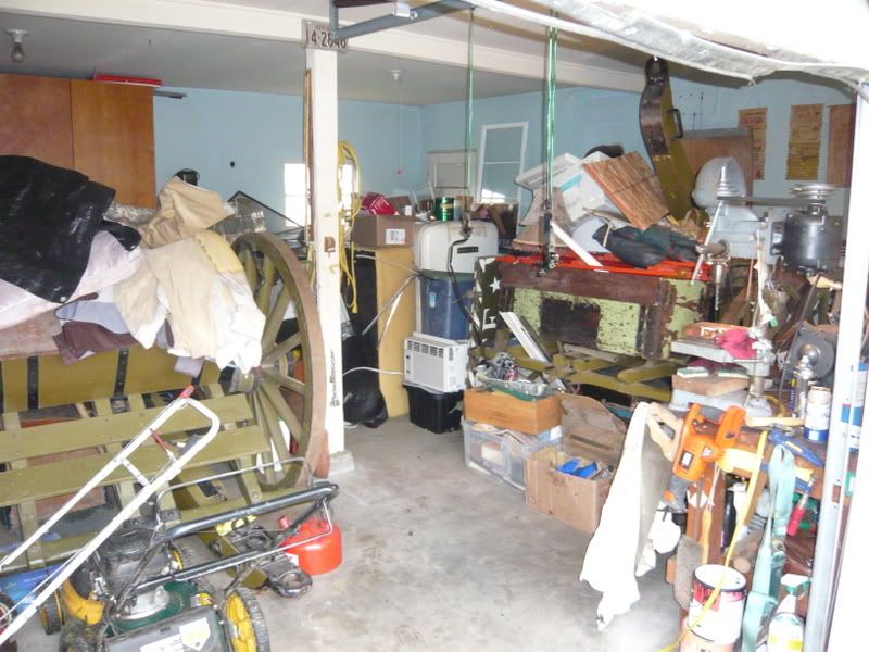

my garage is so bad, that i can't even get my car into it! thx to those 2 civil war cannons. (yes i have pointed them @ my neighbors!)

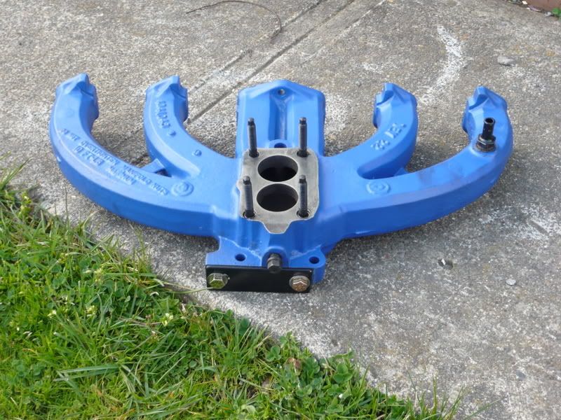

i painted my intake manafold with the frist few coats of paint this eve.
but i spent today scrubbing it clean using 4 wire brushes and a wire wheel, cleaned the carb stud holes,and picked up some nice aftermarket carb studs. i will spend this eve cleaning up and rebuilding the carter bbd.
i am still missing some of the kick down pices if you have any for sale please message me. ~ neil
this is the frist few coats of paint drying:

well i haven't had time to rebuild the carter bbd yet but here is a picture of my finished intake manafold. ( i had to type this out twice cause my kitten likes hitting the delete key!)
hopefully i can get more work done tomorrow on the exhaust manafold & carb.

That looks really nice!!!

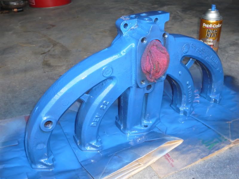

werk on the exhaust manafold:
i have the choke pocket cut out per the supersix article, now is the paint on the flapper parts and the threads. then mopar blue for the manafold. in
keeping with the black hardware on blue theme. (all 1200 deg paint) and yeah the paint gets harder w/ heat.

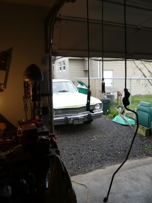

and here is my dart waiting for her new parts
look closly and you can see my kitten " blixa" on the left side

H'mmm. Why we are cutting the choke pocket? The choke pocket is the same (1bbl and 2bbl) on all slant-6 exhaust manifolds from '73 up. You will probably want to install one of the Electric choke kits, which will work better than the nonadjustable stock item (and make the shape of the choke pocket irrelevant).

hmm i wish i would of known that! i am just following Reed's super six page. this makes me wonder what else i am doing wrong. :(
PostPosted: Thu Apr 03, 2008 9:02 am
Posts: 24786
I don't think it's likely you've done anything fatal or expensive — in any event, the electric choke kit makes it irrelevant — but yeah, there are a few technical issues in the Super Six article. Perhaps it should be revised.

i ordered the 2 bbl (bbd) choke kit today from carbsonly. (thanks a ton slantsixdan!)
here is the carb rebuild supplys:
mmmm almedia brewhouse organic ipa .... i wonder what else organic i many need to finish this repair :twisted:
cheers!

That's a red looking brew to be IPA. Not doubting you, just curious.
