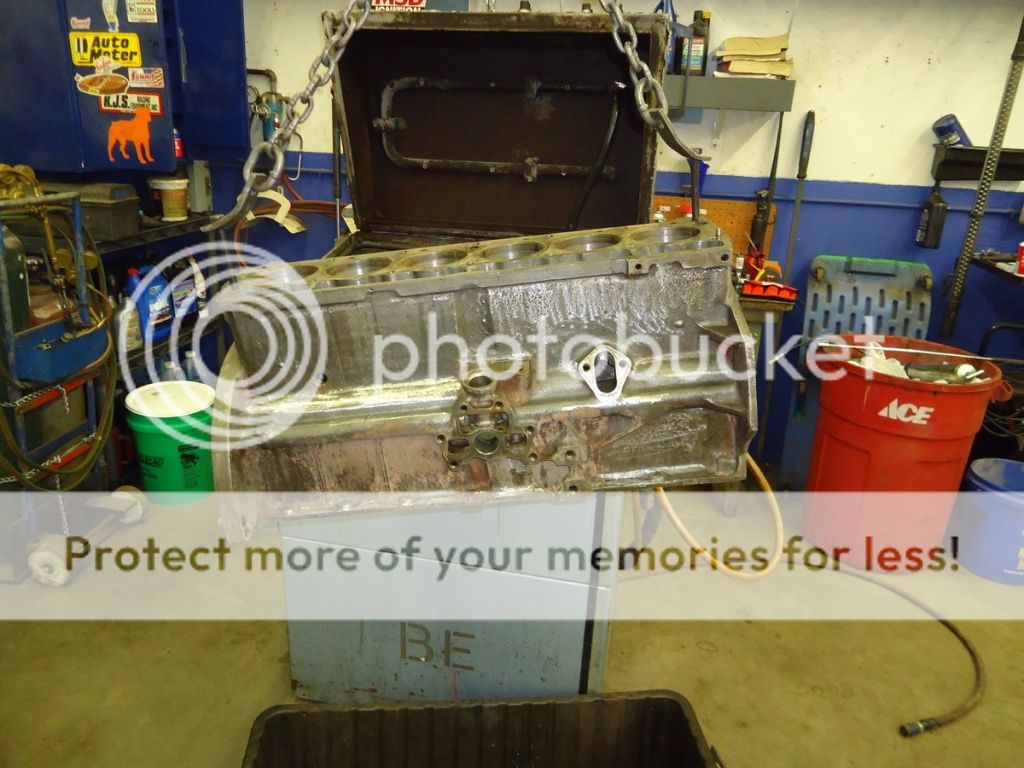

Seeking guidance as I contemplate running an external/supplementary oil line up from the main gallery tombstone pad to the rear of the cylinder head. All input and opinions considered including a verbal smack-down in the event this was covered already and missed by yours truly : )
Thanks in advance!
1) Can a stock oil pump keep up with this and my other 'controlled leak' mod for the oil pump drive gear 'squirter'? (Original pump inspected & measured. Appears mint in every way including drive gear and all measurements are well within spec plus a light porting per Mad Doctor Mod God's specs)?
2) What size fittings and line are recommended for this external upgrade?
(I already tapped gallery tombstone at 1/8" NPT for copper line to gauge but now considering a "T" with a second output for 3/16" Inverted Flare and steel hardline up to rear of head. Steel line would be run 'long' by using a bend or two to deal with flex/expansion<>contraction issues)
3) Should the existing thru-deck oil feed to rear rocker shaft stanchion remain open or plugged or restricted (If restricted, what size)?
4) If this has been covered already, please accept my apologies and please direct me to the story/info/article.
Reference shot showing blank "tombstone" casting at the top rear of oil gallery on my block (now tapped). Click to enlarge:

Why do you want to increase oil to the valve gear? Why not just groove the rear cam journal and avoid external plumbing?

If you groove the cam or run a cam bearing with full groove, you will get more than your fair share of oiling at the top. (Enough to say that I had to modify a valve cover with a rear baffle since the mod allows more oil to reach the top than a peanut plug head can drain in the rear pushrod holes.)
I also see you have an earlier block, and next to the block transmission flange below the block drain plug is a pad at the oil galley passage. In the early 60's trucks these are drilled threaded/tapped for use with an oil pressure gauge, you can either use that spot for your gauge sending unit, or you can thread and tap for your external oiling mod for ease of access later in case a leak develops in your bellhousing.
If you are ordering an OCG cam they can groove it, or they can use one of their "late" blanks that already has this feature.

I would only do this mod if you use rockers that don't feed enough oil to the pushrods and tip like the ones I have on the dart (click the link and scroll down a bit) http://www.slantsix.org/forum/viewtopic.php?t=13007
I have raced this car and driven thousands of street miles with an aux oil rail in my valve cover squirting the rockers... but if you are running stock pieces there is no need. I can post pics of how and what to do.. also doc has info on this.. I just copied what he did.
I would dril and tap the tombstone anyway... you can always plug it or use it for a oil press. gauge.

as stated just need to groove the cam... i would be more curious about 1/8" stand offs in the lifter area to help hold oil in there
