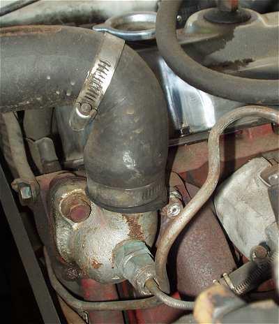

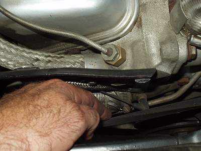

I am not shy about using a drill and a tap but I tend to do my "handywork" on the easest parts to change...
What I have been doing is finding the cast iron thermo covers and drilling / tapping a hole into that, just off-set the fitting a little so the bulb misses the top of the thermostat.
I have also put (moved) the factory sender into the waterpump inlet neck, with this I can see water exit temp. and water inlet temp. (before and after the radiator temp)
