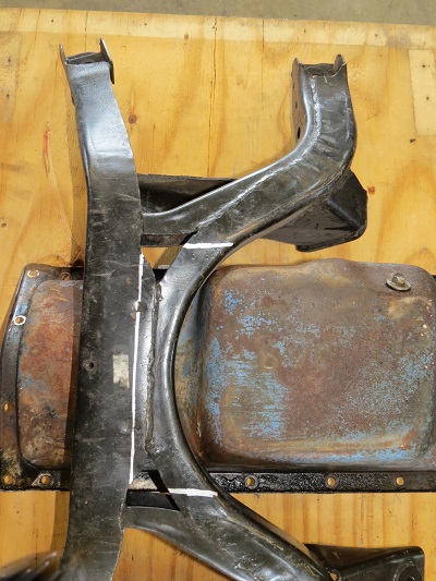

I think the bigger problem is the front corner hits the K frame. The center link helps the rear of the pan for sure. I cut and rewelded my K Frame and now I can run most any pan I want.

Using the v8 center link allows you to use a Fbody oil pan. But you need to trim the front left corner to clear the k-member. I cut it back a 1/2" and weld a plate over the hole. Other pans may reguire a similar notification.

Here is about where I cut and boxed mine. that is an F body pan.
