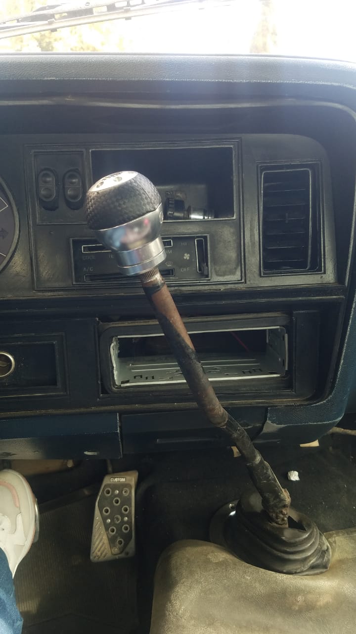

I wonder if the original poster has a NP435 or an 833 OD in his truck.
Some pictures of the transmission or shifter / hump area would be helpful.

Does this picture help

Yes, that is the non overdrive transmission.

So it's a NP435?
So it's a NP435?
I have that trans in my '77 D200..
4.10 Rear Gear Ratio with 235 85 16 Tires
It will do 100Mph or more..
The engine is quite wound up but it will do it.
