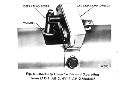

My 65 Valiant did not come with the optional back-up lights. The wiring to the back was there from the factory, so all I had to do was install a couple of sockets and bulbs. The problem is under the dash. The back-up lights are controlled by a switch mounted on the steering column. It seems that if you didn't get the back-up lights, you didn't get the lever that actuates the lights installed on the column, and that is where my problem comes in.
Does anyone know what I might use to replace this missing part. All there is in the steering column is a small, square hole where the lever should be mounted.
I have included an image from the service manual that will hopefully clarify what I am talking about.
1965 plymouth valiant Back-up light switch and lever.png [ 61.51 KiB | Viewed 3097 times ]

When I posted this, I never thought it would go a whole month unanswered. Nevertheless, 77 views later and it seems like we have a real stumper on our hands.
There has to be someone out there in Slant Six Land that has a 65 Valiant or Dart with optional reverse lights and a column shifted 904 automatic. Preferably someone with a column out of a car, which they could post some pictures of, or maybe someone with a part number. Any clue that can help figure out how to make the reverse lights work for the first time ever on this car is welcome.

Valiants are held in higher esteem in Australia than up here, and so there are many reproduction parts available down under that are unheard-of up here. Looks as if the clip-in actuator you need is such an item; buy it here. I've verified the part number in the '65 factory parts cattledog; this is the right one. You're on your own for the (nylon, I think maybe?) washer, but that shouldn't be too difficult.

If you have room, you may be able to drop a thread insert into the hole and crimp it fast. Then screw a short stud in place and lock it down. Or just spend $30 for the easy /right thing. Good luck

Looking at the illustration from the shop manual, it appears that this steel clip is wearing some sort of sleeve.
I hope this doesn't become important because the item I have on the way is the metal part alone.
