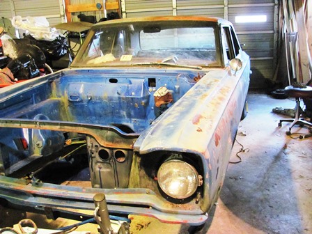

I pulled the front fenders off and stripped all the remaining items from the engine compartment in prep for paint. The engine compartment is in much better shape than I thought. Just needs primer and paint.

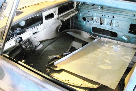

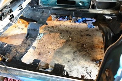

It seems that AMD has discontinued floor pans for the 65 Belvedere so I bought one of the last ones they had. The current floor is a bunch of metal patches (some very poorly installed). I figured I may as well install it now and be done with it. I cut the old floor out, just need to trim up the edges and set the new floor into place. Maybe now, the carpet will finally lay flat.

I would have considered an aluminum floor but I already have the AMD floor. I will be adding frame connectors. I haven't decided on tube or square stock for those, I have both on hand.

I have the front floor pan test fitted and just about ready to weld in. I can't seem to get the holes to align for the seat brackets and the outside seat belt mounts. I may just have to get them as close as possible and redrill if needed. I need to level the chassis on the jack stands before I start welding. I noticed that the passenger side isn't sitting completely on the jack stand. This is due to the right side leaf spring being stiffer than the left. I just need to drop the axle off the stands so the chassis is resting firmly on the jack stands.
