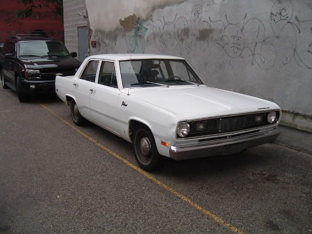

Hello and welcome. Ok so here's the story behind the car. My wife just had a baby, well it was about a month ago or so. She informed me that I was not allowed to transport the little man, right little, he weighs almost 15lbs already, in my truck.
So I set out to buy a 4 door car. She happily agreed to this. Hehe, little did she know what I had in mind when I said I'd get us a 4 door car. I found this little beauty on E-bay. Yes I know it can be dangerous, but I asked as many questions as I could, got all the pictures I could think of. And I won! I won her for $750.00. I drove out Saturday the 27th and drove back with her the same day. That /6 was doing really well, I did stall out once at a red light, but that will hopefully be fixed in the coming week. I also have a new carb and Electronic Ignition coming this week. Well, lets put up some pictures.
A nice 3/4 shot of her.
